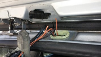

Tell Your Mechanic to "Raise the Lift Gate" and check the Wiring passing through the Upper Body into the Lift Gate through the Rubber Flex Boot and look for any Broken Wires. If there are any damaged inside there from Work Hardening and Breaking while Hidden inside of the individual Wire Insulation that will appear Okay... WEIRD Things like THIS No Start problem can occur since the LGM has a Class 2 Connection with Key-less Entry in some cases and IT communicates with the BCM, with Multiple Locking Components along with the Rear Electric Windshield Wiper set-up... all going on... all at once:
View attachment 108757View attachment 108758View attachment 108759View attachment 108760
You know! I’ve watched some videos on Class 2 failure and I was considering telling him to check that. Even if those wires are broken would I still be able to hear the locks on the lift gate working? My rear wiper and washer work as well. I’ll tell him to check it out regardless. That lift gate saw a LOT of opening and closing when I was working on the DoD delete.
