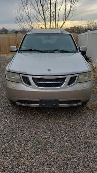

You can see the pics of my 9-7x with the headlights I have for sale in this post...
What are you looking to get for the turn signal stalk? I might pass on the headlights as they don't look a ton better than mine, but what are you wanting for those?
