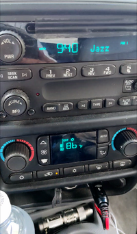

I have a 2008 Trailblazer, and the sound starts cutting out repeatedly, sometimes quickly like a machine gun, and sometimes slow. At the same time, I hear a clicking noise behind my head.
- factory stereo, 99% sure it's non-bose
- vehicle has onstar, but we don't pay for it, and never use it or touch it
- the radio illumination itself doesn't blink or flash, it stays on constantly when the audio is cutting out
