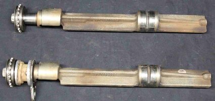

Oh... and in regards to what the Intake & Exhaust Internal Counter-Balance Shafts look like... Here is an image that shows they look like the Compressor-Impeller Blades inside of the Old GM 671 Blowers (Super-Chargers)... :>)
