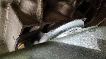

#1 Discover @ Exhaust Manifold Heat Shroud Removal:
-.EXHAUST MANIFOLD VANE ON CYLINDER #3 IS CRACKED.-
-Revel In Amazement-
-Regroup-
-Pray To God-
-I'll pick this up again tomorrow-
!!!CHEERS!!!
