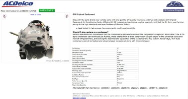

If it turns out to be absolutely required... Abandon any notions of using anything other than the GM OEM ACDelco or Delphi Brand A/C Compressor.
THIS is the one you want... and RockAuto has it for around $290.00 + S&H:
Since it is an OEM Brand... unless you want to do all the grunt work yourself... a Legit A/C Repair Shop should agree to performing the installation using the Compressor you supply for the Price of Labor, plus the additional things needed for a complete repair:
