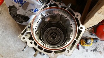

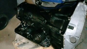

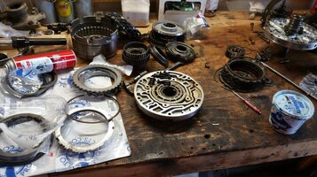

- Complete trans rebuild
- Beast sunshell
- Dual cage sprays
- Kevlar band
- painless accumulators
- .50 boost valve
- hardened seats on the separator plate
- red frictions and new steels
- 04 trailblazer bellhousing
- 04 buick reiner front and rear drive shafts
- 2500 stall converter
- custom transmission crossmemeber

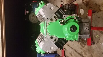

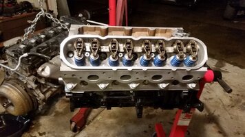

Engine Mods
LM4
LS9 Cam Factory Gm Part Number 12638427
GM Performance Valve springs 12499224
Milled heads, blended bowls
Trickflow timing chain tensioner
LS2 timing cover 12633906
LS2 Timing chain - 4x Timing Gear set for moving the cam gear to the front. 9-3672TX9 Cloyes
2200 Stall Converter

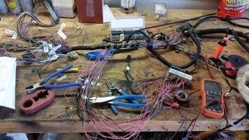

Moved the battery to the rear and made this mount for the PCM and realys for the fans and lights.
Below you can see the donor harness and the C1 connector from the factory Envoy fuse block becoming one. Utilized the factory fuse block and all the fuses are still labeled for the correct items. The donor harness was a 05 Chevy Silverado 2500.
- Beast sunshell
- Dual cage sprays
- Kevlar band
- .50 boost valve
