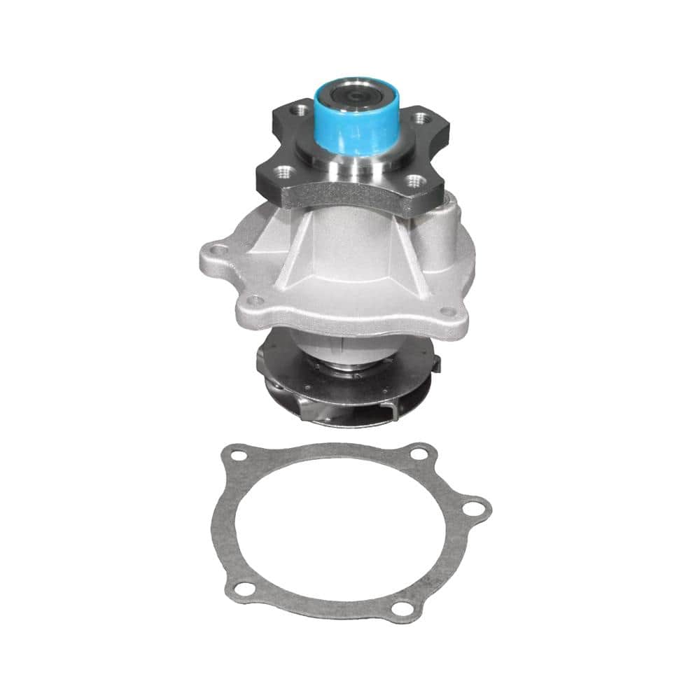

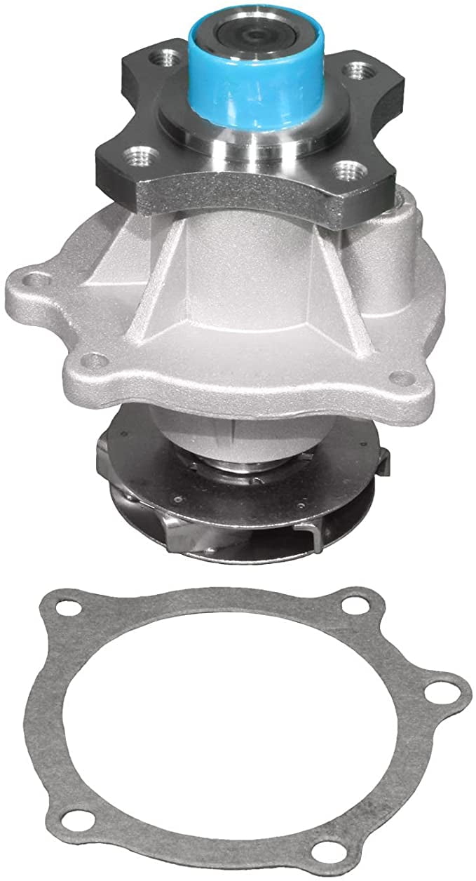

Now when I was searching I couldn’t believe finding this. I had no idea Home Depot was distributing auto parts now too…. It just blew my mind that they had 10 in stock.
It's probably a front for another company using HD's site, like Walmart, which is EXACTLY the same price.
Looks like ACDelco has gone to a fibre gasket. The metal one, which you can tell by the bead all around, is available separately on RA. And if you look at the pumps there, some of the others do have the metal gasket, including the Melling. There's also the GMB and FVP (which is a GMB). The gasket from Victor-Reinz is just $1.07. Personally, I'd give Melling a shot. It's $5 cheaper and has the metal gasket.
