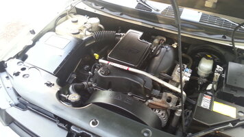

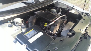

Mission for the weekend accomplished. I used simple green and some elbow grease, quite happy with the results. The engine bay was grey from dust and dirt. Wish I took a before pic.Thanks for the insight ppl.

I am not sure anything would clean mine at this point, but those pics above sure made it look much nicer to work on the engine than mine does. Well Done!
