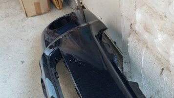

I attempted it but the freshly painted Denali bumper cover had an accident the day I was going to install. I'm going to get this done just not high up there on the todo list for me right now.20171117_113351.jpg20171117_113358.jpg

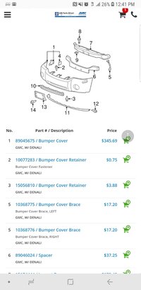

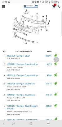

Hope you didn't forget the braces. I forgot to mention they are a little different. #5 in the first pic is what you want. #4 in second pic is what our sle and slt model envoy have.Screenshot_20190122-124140_Samsung Internet.jpg
