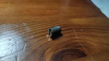

I noticed some noise at the right side of the engine. Here is the noise when the engine is cold. Also, sometimes, when accelerating, I hear some slight ticking noise from the right side. I replaced the donut gasket but the noise is still there. Do you guys think I have a crack in exhaust manifold?
) as I figure I could move up on bolt size go to SAE (which ever was just a bit bigger). I used a tap to make the happen. I used a dremel carbide grinding bit to help a bit. You can't go too much bigger in bolt size as then you will have issue with the manifold hole. Ulimately, if things fail, I guess the next thing would be utilizing a helicoil insert.
