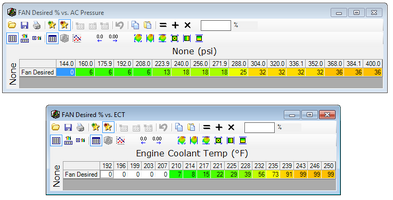

It sounds like your new clutch is operating normally. It's not uncommon to get the jet engine roar sound at first on a cold start, and then it fades away after a minute. I used to have a pic from HP Tuners that shows the chart of commanded fan clutch lockup percentage vs engine coolant temp, but can't find it. In short, it's not really asked to do much of anything until things get over 210.
Does your fan roar EVERY time you start the truck? Or only from cold starts?
Managed to find the screen shot. As you can see, the fan isn't going to get going due to heat, until thing really start cooking. You could try turning on your AC as a more immediate test though. :twocents:

The reason it bothers me so much is because the fan I replaced did not make the roaring noise at startup. And with the replacement, the noise seems excessive, as if the desired speed is less than the actual speed.
If the fan is not matching the desired speed at idle, why would this be?
If it does not match the desired speed while in operation, I believe this would still indicate a problem, right?
The idle is also rough, which I believe is due to the fan being locked up, as the idle was perfectly smooth before the problems occurred. What are your thoughts on this?
Thanks for your help!
