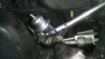

this though is the fuel pressure regulator (FPR)...This is a pic of when I replaced mine because it was leaking...

#3 - Check the fuel pressure regulator for leaking
