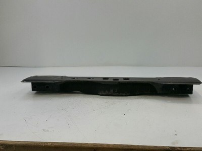

@coolride ... You might just save yourself an awful lot of Time, Money, Energy, Flux-Wire and Hassle by using an existing Trailblazer Box Framing Section cut from THIS Article and minimize the work and the welding necessary to perform this repair AND make it look more "Official". Take a peek at a few of these being offered on eBay for around $61.00:

Of course.... No insult intended. The suggestion though was that this "Ready Made Steel Box Frame" could perform as a stand-In after you carve out the length and breadth in the shape(s) required to fit on and over the damaged, rotted out existing areas. You could do wonders with it using a Tape Measure and 4" Cut-Off Wheel.
That crossmember, similar to the one for the rack and pinion, is actually made of thinner sheet metal, boxed and pressed together and would not be suitable. However, that brings the idea of using a piece of an actual frame if you can get one. If you go to a PnP yard with a sawzall (mine doesn't allow torches or grinders), you might be able to cut out a section or ask a regular recycler to cut a piece out for you. Then, just cut a patch panel out of it to weld on.
I thought I might have given the impression that my cross-member was rotted out. And I also thought you might be just endorsing the general strategy of using salvaged frame sections. Wasn't sure.
