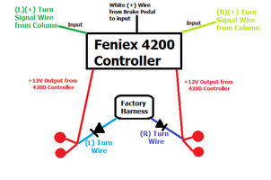

SO..... Assuming I understand how the power/signals come from the column turn signal wires, and the brake wire....
1) +12V Inputs from Brake Pedal, Left, and Right signal wires from column/under dash
2) Output from controller to both (L) Brake lights, to one control wire
3) Output from controller to both (R) Brake lights, to one control wire
4) Factory Harness to same control wire as both (L) Brake Lights (w/diode)
5) Factory Harness to same control wire as both (R) Brake Lights (w/diode)
6) Brake power for all lights will come from the 4200 Controller
7) Turn power for each side to come from individual wires in Factory Harness
8) Constant +12V from (L) Turn wire from column will make the 4200 Controller disable output power to (L) Brake signal.
9) Constant +12V from (R) Turn wire from column will make the 4200 Controller disable output power to (R) Brake signal.
I think you're on the right track.
Awesome!! I am (somewhat) mechanically/technically inclined, however I am a visual learner, and writing about and seeing are 2 different things. I am SO thankful you spurred me to think of using an existing thing I have to overcome this challenge!!
I think you need diodes in the lines feeding from the Fenix controller as well so power doesn't go back up that line and take out the controller. Take a look at this writeup; http://forums.offroadtb.com/viewtopic.php?f=69&t=2966
I thought at first, but since the input from the turn feed would disable the output, I figured it would be a closed (or open?) relay, whatever lack of continuity would be, in a relay.
I suppose either way it wouldn't hurt, right?
Adding them would not hurt. Even if there are diodes in the controller.
I wouldn't have thought of diodes just because of the relays, but you're right it can't hurt.

Ok, so I kinda stalled my project last year. Tried to sort out a few details, and I think I came up with a pretty good solution.
Updated my schematic with the clarified details.
Steps Done Towards Install
1) Purchased the Novita LM486 LED Flasher module to help avoid Hyperflash.
I was not 100% sure if I would need this or not, since I plan on wiring the 2 separate HAWs on each side together to flash. Since NORMALLY only 1 bulb flashes on turn signal, and the 2 lower draw LEDs will be wired together, maybe it would increase the draw enough?
Either way, I have it just in case.
2) I purchased a Hopkins Trailer Tail Light Converter, which will allow both turn signal & brake function commands on one single input.
3) Purchased (2) Delphi GT150 Female Connector pigtails to plug into the factory taillight harness, and avoid cutting and splicing.
4) Have an old abused set of tail lights I am using to mock-up the lights, figure out how much and where to trim to get the LED HAWs to sit far enough inside the housing to best utilize the reflector. (I HAD a couple videos, don't know what I did with them :Banghead:)

2) I THINK.... I figured out MOST wiring (where I need to tap into for power for specific functions) based of a couple PDFs from the old site, installers use for aftermarket alarms/remotes, but wanted to confirm with actual schematics as listed above.
a) Ignition - Pink OR White wire in Ignition Harness
b) Left Turn - (+) 12V (constant) Dark Green @ turn signal switch or flasher
c) Right Turn - (+) 12V (constant) Light Green @ turn signal switch or flasher
3) I need to determine
a) Either the (+) or (-) for the Park/Neutral switch (is this the same as the Parking Brake, or
is the parking brake also known as the Emergency or hand brake?)
b) (+) signal for headlights (and not power signal for the DRL).
I don't think the chassis wiring changed much, lighting-wise anyway.
The parking brake is also known as the emergency or hand brake. It isn't the same as the park/neutral switch, that's on the transmission.
Thanks Sparky, I was pretty sure that was the case the more I read into it, just wanted to double check!
