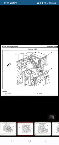

Hello. The ground that I believe to be g106 is highly corroded and I believe when going to fix this, I am not going to be able to find a clean surface to attach to. The entire area is very rusty. I was informed that where it looks like there is a crimp or connection of two cables where the corrosion is at the bolt, it runs after g106 to the block. I suppose it's possible under all of the green corrosion there aren't two wires crimped and it simply one wire bolted here and then continues on, but I was giving the impression there is a connection from battery to g106 and then a second connection that runs to the block.
When I attempt to fix this, if I am correct and I'm not able to get a rust free surface, what would be an alternative spot to ground to? I understand I can use various bolts already in existence, but it's my understanding I want the shortest path possible. Plus there's not much without thick rust to work with.
The plan I was given was to either run all new cable, or, splice in a section of cable that would be either soldered or crimped with heat shrink. Editing this to add that I think I could buy a new battery cable that would run directly from the terminal to my new ground and then hopefully have enough length to connect to where it needs to then run to the block. I don't understand why it was suggested I would splice in between g106 and the battery when it's just a short distance unless it's because of cost.
If I were to cut the cable between the battery and g106, I would need to then attach to the chassis or frame and of course then make sure I have cable connected from that spot and spliced into the one coming off the block.
I am unsure how to determine what gauge battery cable I need and how to go about finding a good ground point in this area when everything seems very thickly covered in rust where the original g106 is. It is my understanding the ground at the block is fine but that midpoint g106 is a problem.

I cant swear to it, but I think this is the ground cable you are looking for.. @Mooseman or @mrrsm should be able to confirm.
That said, you can attach that to any existing bolt/nut location at the frame... I will have to take a look at mine to see what other options there may be. I am fairly certain there are quite a few options thou..
You could run it forward to the bumper frame horn, and get the same result.

Trying to shop locally as opposed to ordering online and waiting and I found this which I'm thinking looks a lot like my situation. If I'm understanding this picture as opposed to the one you supplied, I'm thinking that midsection where the bolts would go through is where I have the corrosion at g106 and this piece would solve it but I'm not sure I'd be able to reach in far enough to access g110 where I believe the final end connects to the block.
I'm not 100% sure I'm understanding the diagrams I've been using correctly or this product that I'm looking at correctly but it does seem to match what I'm looking at in my vehicle.
If I can't access g110 myself, then I'm going to have to take this in and pay someone to do it which is frustrating after receiving the quote today. Additionally, I'm finding it impossible to figure out what size that bolt is in case I do successfully remove it and clean the area but need to replace it with install. I was hoping to have all the parts here at once but I can't seem to find what size that bolt is.
I think your link has me on the right track, but it's a different year so possibly a different setup? I also found an AC Delco one on RockAuto but it doesn't look like mine versus the NAPA part one looking very similar.
As for the bolt, GM is pretty notorious for using nearly the same bolt, thread, and pitch, across an entire manufacture. If that applies to this bolt, I dont know.. But its GM, so likely.
As for the "local cable", I only see one problem, that second, shorter, leg, doesnt appear to have the length needed to make it to the body ground. Everything else may be good for the application.
G106 is the main ground from the battery to the body/frame. If you remove it, you should be able to clean it down to bare metal. It's the strut tower and I can't imagine it being so rusty that you can't find good metal there. A wire brush or even coarse sandpaper should be able to clean it. Don't forget to clean the eyelet and bolt.
That's kind of my problem. It's pretty much solid rust in there from a visual standpoint. I will be working on it tomorrow but my concern is that I'm not going to be able to connect there. With all of the other ground chasing and fixes I have done, I didn't even look at the main one from the battery because two different auto shops did and told me everything looked good. So I focused on all of the other grounds like under the driver side door and in the rear underneath and under the radiator etc because they didn't have any interest in checking those all willy-nillies so I at least had them check the main one from the battery which was apparently a waste of money since I found this on my own. It was only two nights ago that I was moving the wiring harnesses around and happened to see it and got concerned I don't have a good place to connect. I'm certainly going to try, but I can assure you that it's rust city in there. :(
As a final test you can check for a voltage drop across the connection with the engine running and lights/fan/etc tuned on. With a multi-meter set to Volts DC, touch one lead where the wire goes into the eyelet and the other on bare metal just adjacent to, but not touching, where the eyelet attaches to body ground. A resistance across the connection will translate to a voltage when current is passing through the connection; ideally should be 0V.
