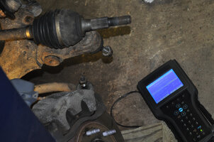

I jacked the right front wheel and engaged the 4WD. It was obvious that the right axle was not connecting to the differential side as it should when in 4WD. I removed the electric actuator of the disconnect assembly and actioned it in my hand with a Tech2. Its plunger worked okay. I placed a drift in the actuator hole to mimic the electric actuator and rotated the right tire. The axle would not engage no matter how hard I pressed on the drift. I could feel the sliding fork move smoothly within, everything felt okay, the grease looked clean, no metal shards could be seen. It was a mystery why the disconnect assembly was not working, but removing it was the next thing to do.

I made two attempts to remove the old assy. On the first. I could not remove the right CV axle assembly without separating the lower ball joint from the steering knuckle. Although the manual says this is not necessary, In my case, it was. I did not have the proper tools to do this, and the car is my one and only daily driver. I reassembled the car. 9 hours work, but next time would be a snap to get back where I left off.

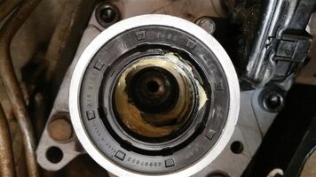

I applied quite a bit of torque to the jack screws until the assy popped. The oil pan is remarkably strong. What popped was the casting of the assy. This was a nerve racking operation, but I would do it again. The oil pan is strong. The force required to break the casting is substantial and highlights how fused together these parts were.

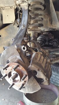

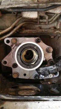

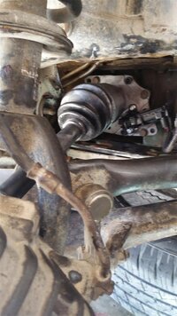

Here is the assy. You can see where the casting broke.
pic 2

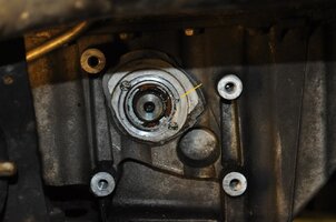

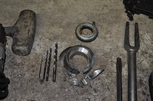

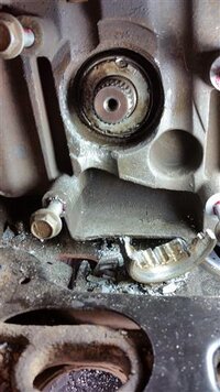

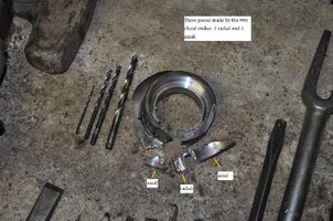

and the oil pan with the broken piece stuck in the oil pan. The assy oil seal prevents removal of the intermediate shaft.
pic 1

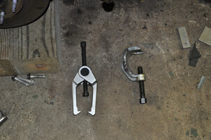

I purchased online two tools called out in the manual, which I now consider a must for this job.
1. J43631 Lower ball Joint Separator. used $128 on eBay.
2. J24319-B Puller. Substituted OTC 7503 Outer Tie Rod Remover. ToolSource.com new $55 plus $10 S&H. http://www.toolsource.com/outer-tire-remover-p-62094.html
pic 12
I would caution against buying China imports, as these are high stress tools. I looked at a look alike HFT puller and saw the jaws were thin, not aligned, could not tell if forged or cast, and the screw threads were not smooth. OTC7503 can be anyone's part number. Be wary buying online. You want to see the "OTC an SPX Brand" logo. Ottawa Tool Company is the best.

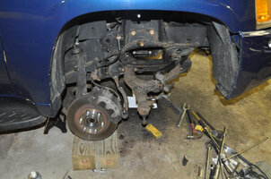

- Loosen wheel hub axle bolt, wheel lugs, jack car, remove tire.
- Disconnect speed sensor wire at the plug on the chassis back to the steering knuckle. To disconnect the electric plug: first pull it straight perpendicular from the chassis frame, then remove the grey safety lock by depressing the middle barb with a small screw driver while pulling, then disconnect the plug by squeezing the locking tab on the neck while pulling apart the plug assy. Disconnect the speed sensor cable clamps with a small screw driver prying up in the hood pocket.
- Disconnect the brake line clamp on the back side of the steering knuckle.
- Disconnect brake line mounting block on frame.
- Separate outer tie rod from steering arm.
- Separate stabilizer link from lower control arm. You will need a 7mm Allen wrench.
- Separate strut yoke from lower control arm.
- Unbolt 2 upper strut bolts from chassis mount. Remove strut from car.
- Separate upper ball joint from upper control arm.
- Separate lower ball joint from lower control arm.
- Pull wheel hub steering knuckle assembly from front axle. Set aside on blocks under wheel well with brake line still attached.
- Remove right front CV axle using a brass drift and 2 lb mason hammer against tripot housing.
- Now you have clear access to the front axle disconnect.

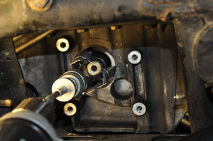

To remove the stuck assy from the oil pan:

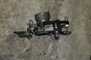

Use 3 jack screws, 3/8-18 x 2.5 full thread, with square nuts on the backside of the assy. Distribute the point load of the jack screws on the oil pan with thick metal backer pads. Jack screws are the socket head cap screws in pic 8 . Square nuts are not as likely to spin without a wrench. The steel pads are about 2 x 2 x .25, 2 x 3 x .38, and .75 x 2.5 x .50 and small filler block .50 x 1 x .31 Just scraps I had lying around.
pic 8
pic 9

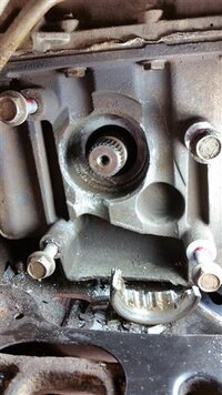

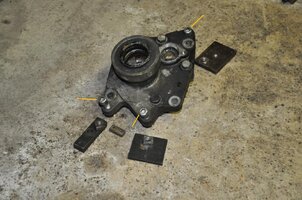

pic 2

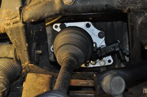

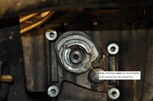

pic 1
