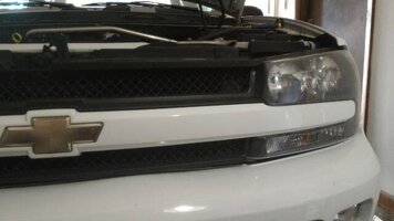

I would like to remove my left headlight assy to acquaint my self with the procedure and be able to remove the plastic cover for oxidization removal. How is the bowtie strip separated from it ?

:goodpost: There's 4 clips across the top of the grille, 2 on the bottom at the corners, one behind the bowtie, and 2 on the bar in each headlight. The ones in the headlights can be a pain to pop loose for sure. Removing the headlights and grille as one piece is a good idea until those clips get loosened up (if you have to remove them a few times)
Rod, in case you can't visualize it, here is a video on the process.
