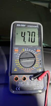

Decided to try to cram the meter probes in the back of the pigtail, have it plugged into the motor, so when it did play nice, I could get the voltage readings for comparison. The leads were a little too long, I could get the positive pin wedged in place, but the ground side had the dash bracing in the way. As I'm fumbling around with things, I bump the dangling resistor pack, and the fan fires up full blast. Touch the ground probe to the splice pack bolt, and get 11V. That's closer to what I was expecting. Engine on, was getting over 12V.
To get some comparison data, I decided to prop up my meter, go through each fan speed setting, and grab a pic of the voltage. That way I could compare the resistor pack output when it fails again. Got through speeds 1 and 2, and then the fan cuts off. Voltage reads 0, unlike when I started out :laugh: Gonna go ahead and order a new resistor pack

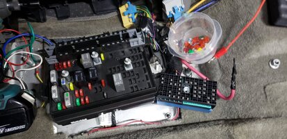

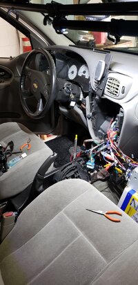

So I took apart the radio stack, figuring the biggest likelihood of an issue with wiring would be here, considering how much stuff I have crammed in there for the HU. Turned the key on, grabbed, squeezed and shook the wire harness for as far as I could trace into the dash. No joy.
:lightbulb: Then had an idea, what if the problem was with one of the traces on the fuse block, kinda how they have failed on the front ones for folks and caused connectivity issues. So wrestled with the back seat to get that out of the way, taped off the power supply from the front fuse block, and got to taking apart the rear block. For the life of me, I couldn't figure out how to get the 2 halves apart to access the traces, so took a detour. Since I had the connector off, try checking for continuity between the fuse block end, and the HVAC controller end.
Couldn't get a reading, but wasn't 100% sure if that could have been from me trying to daisy chain wires together to reach that far. Then I counted 11 thick brown wires coming from that connector, all in row 8. Meaning tracing the wire through the bundle to the radio stack would not only mean taking much of the interior out of the truck, I'd have to untape the whole bundle to be able to keep the correct wire pulled free for testing. 👎 Immediately lost all interest.
Put everything back together, and turned the key to make sure everything went right with reassembling the rear fuse block and guess what? The blower motor kicked on, and worked on all speeds. :duh: We'll see how long this lasts. I would hope that would mean that whatever problem with that wire is right there near the fuse block, but given how thick and secure that bundle is, I have doubts. At any rate, thank you Amazon Prime free returns, the new module will be going back.

Got the fuse block taken apart, and found something unexpected. Top side of the block looked fine....
Pulled the board from the base to check out the bottom, and found some melted plastic on the pin exiting the HVAC blower fuse. :undecided: Something tells me, that might be a problem worth fixing. Grabbed my Xacto knife, and scraped away as much of the melted plastic as I could.

Got the lower kick panel pulled, and removed the glove box. Forgot how much contortion is necessary to get up under there, definitely don't have many years left in me to be able to do that lol Got the 5mm screws out, pulled the resistor pack, and the smells that I had caught before, were evident here.

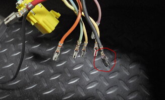

Pulled the control module connector so I could get a better look, and the ground pin had melted plastic at the base. The connector itself showed some signed of melting too. Culprit confirmed
Since I was already in there, and had everything apart, decided to test all of the pins in the connector, just because. Everything had voltage when it should have, which was reassuring.
Have an aftermarket resistor pack, with replacement control module pigtail in route from the blue smile site. Going to try and de-pin the connector, and see what condition that ground wire pin is in. If all it needs is melted plastic scraped off, I'll just repurpose the housing from the replacement, and not have to splice all those wires. Worst case, I just have to splice the ground one by itself. Kind of annoys me that all the wires are black and white, instead of color coded, but I suppose these might have been used in multiple GM models
New resistor pack arrived today. Got the old harness de-pinned, and the ground wire pin was looking pretty bad, so snipped that off and spliced the new one in.
