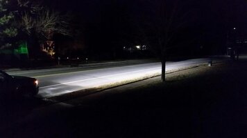

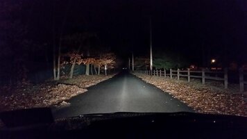

Just would like to add some output shots from the projectors.
Low beams up close:
High beams up close:
Lows on a dark road:
Highs on a dark road:
Lows on a side street:

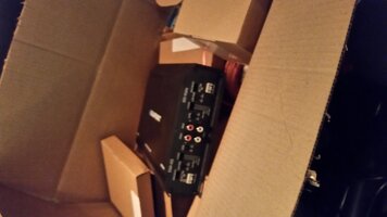

Between yesterday and today I did my amp install. I used a Blaupunkt Ema 455 and ran new wires to the doors and full RCAs from the back of the head unit. I don't really have any pictures of the install since I was annoyed with the progress I was making, it was slow I started at 11:30 today and only finished at 6:30. There is no alternator whine so that's a plus, and it sounds a lot clearer. I'll add finished product pictures later.

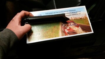

On Saturday I performed the cabin air filter mod. A mod I've wanted to do for quite some time.
These are the parts needed for the mod, a door and filters. (Not shown self tapping 1/4 inch #8 or #6 (I forget will update later) hex head screw)
The foam I used to seal the door against the hole.
The tools required to remove the existing block off panel, I used this method because I didn't want dremel particles plugging up the passage ways.
The opening that is created when the panel is removed.
The new door next to the old block off plate.
The door installed with the filters behind it, there is no noticeable reduction in air flow. There is a very slight leak, but its minuscule, not even enough to move a piece of tissue paper.
I know I've been beating around the bush with this, but as of right now these are the only 2 other pictures I have of the amp installed, more are to come though.

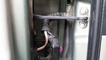

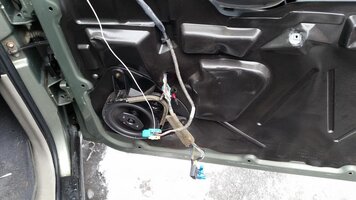

I chose to keep all the wires organized, all ends are crimped on as well as soldered to the crimp terminal. (not the amp :rotfl: )
The wires to the door were tricky, my clip has been broken for a while, its on my to fix list. :raspberry:

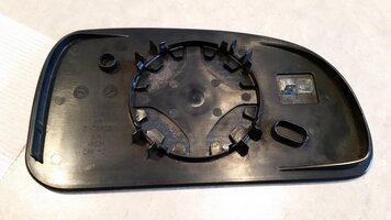

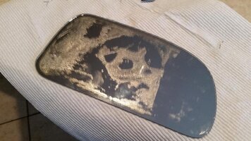

So I did my turn signal mods the other day, I followed the tutorial in the article submissions section and it wasn't too bad. I used a hair dryer to separate the glass from the backing.

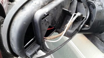

The pins I bought to wire into the ddm harness for the directionals

I notched out the back of the holder for the insert:
Work:
How I placed the tape:
Done:
Moments before it fell:
Installation on the car:
I went straight to the mirror harness since the slot was already there, maces removal easier if it has to be done too.

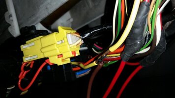

So I did the starting the car with no driver mod this weekend. (some may call this remote start.)
Part came in on Wednesday, I didn't see them till Friday, it was torture.
Started out pulling my tools and testing wires, yes I have diagrams, but things change. I wanted to be sure.
DMMs are your friend. :yes:
Put in the hood pin, you know, so we can be safe. :raspberry:
Just to prove a point, I do solder everything I do, yes it takes more time, but it's one less failure point.
Not my best, the iron was a little small for the heavy gauge, I hit it again don't worry.
Wiring mess
Everything all secured in place
Buttoned up
