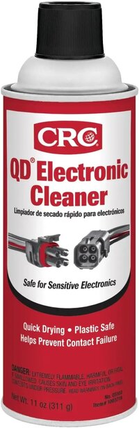

CRC QD Electronic Connections Cleaner is THE BEST Solvent for doing these "Clean Ups":

From what I have seen, I can spray that the CRC QD Electronic Cleaner on the PCMIA card male end and the female receptacle that it plugs into, correct? Same goes for VCI as well? As I understand it, this cleaner can be sprayed on de-energized circuit boards, and pretty much anything electronic?
