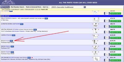

Without trying to sound "TOO Sage"... in our collective experience... There are Only TWO Kinds of After-Market Fuel Pumps:
(1) Those that have FAILED...
(2) and Those that are GOING TO FAIL.
The wisdom that follows with this hindsight is to choose from the Fuel Pump List below...and focus on the one with the Red Arrow drawing your attention to it should the need arise post-diagnosis for its R&R:
The wisdom that follows with this hindsight is to choose from the Fuel Pump List below...and focus on the one with the Red Arrow drawing your attention to it:
