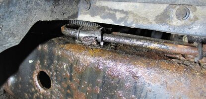

It leaks like a small river. I think this is the return line to the cooler (closest to viewer,) and the line with the leak. Obviously that bracket is toast. Can these lines be replaced with flex hose?
Reactions: BrianF
You can if you just want it to survive for a little while longer, though I'd try to put some sort of a flair on the ends so that it'll hold a bit better than just sliding it on the hard line. Even the return side of the PS system does develop some decent pressure when it heats up since there's no vent, and it'll be enough to eventually blow a line off of just a straight cut line.
Reactions: coolride
I've used hard brake line with compression fittings with success. Hard part is getting to clean unrusted old line.
Reactions: coolride

If it's the big one on top of the shock tower with the big piece of rubber that retains water and rusts the lines, ditch it. I just zip tie the lines to the remains of that bracket. Eliminates the source of the rust.
That shock tower clamp is good. A little rusty, but it will clean up. The lines under the rubber look better than any place else.
Hard to believe that genuine GM parts are necessary. Can anyone recommend a good after market supplier?
Not really a "high runner" part in terms deployment and design. Unlikely to find much cheaper replacement just because nobody would spend the effort to manufacturer outside of GM and its suppliers. You can try using a "bow tie" like DIY design using the "plumbing hanger strapping" which can be either gavanized or copper based. Basically, have the strap come together in two "U's" with the ends meeting / aligning in the middle where you then pass your bolt thru (pick your length well to align the holes) and thus holds ends AND goes thru the main base portion of the strap and ultimately back into the hole where the frame point is. Probably cost $1 IF you have strapping already or 5-6 $ if you have to buy a roll from HD.
Here's a look at the shock tower lines. I've got half a mind to patch the segment that's leaking, but might seriously consider replacing everything, if there was a good quality aftermarket option.
