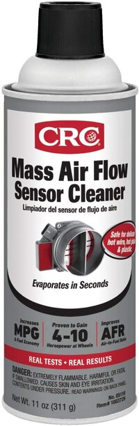

(2) Clean out a Dirty MAF (Mass Air Flow) Sensor...Use ONLY CRC MAF Spray Solvent:
