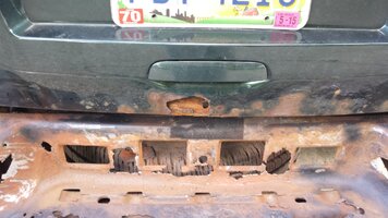

I was showing my son what worn out shocks look like by kicking the bumper on my Trailblazer, and pieces of rusted metal fell on the ground.😱 Anyone have any suggestions on how to replace the hitch and adjacent structure? i don’t have a welder or know how to weld, so I may need to take this somewhere, but I really don’t want to. anyone use a welder from Harbor Freight without any experience? Other suggestions?🙂

Is it actually rusted through or just heavy surface rust? Grab a screwdriver and start hitting it. If it's still relatively solid, I'd leave it alone. It's part of the actual frame so if it does need repair, it has to be welded. May need to find a good one from a junker and have it welded in. Not for a DIY job unless you are really familiar with welding heavy steel.
I would check the rest of the frame as the hitch may not be the worst of the rust and you may want to go to plan B if you have rust through in critical areas.

Mine was roting out to the point thar my foot was almost going through the bumper, but the frame part itself, while very crusty, was still solid. Neighbor was kind enough to weld up some steel on it to reinforce the bumper steps to make them usable again. He used some scrap 1/8" plate steel. Ha that easily outlasted the rest of the vehicle! This was back in 2014.
89464
Sadly what was the death of the vehicle in 2016 was the frame rotting away behind the passenger wheel.

The Hitch/Bumper is just a bolt on crossmember not a subframe.
We pulled mine off when we built the rear bumper and used 3x3 1/4 tube to build a hitch into the new bumper.
I would double check the frame where the hitch bolts on.
Should be simple enough to find a hitch and slap it on there.
Reactions: Kurb and Mooseman
X2... I don't believe the hitch itself is anything special. Likely an aftermarket can be made to fit. You can readily peep under and see the bolts that hold it to the frame rail members.
Reactions: Kurb

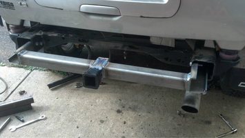

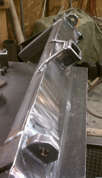

You can see the simplistic mounting on my rear when we were building it.
89591
89592
And this pic of Mike building another shows how it mounts.
89593
For reference...this is the stock hitch/crossmember
89594

It’s definitely more than surface rust. Pieces are falling off of the cross member. It’s great that it can be replaced, though. I’ll add it to the list of things to do. I guess I also need to inspect the rest of the frame. Thanks everyone for all the replies.
