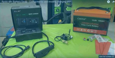

I probably need some assistance and advice here from @Blckshdw right now to ...Talk Me Off The Ledge... about the need to completely replace the Four Lead Acid 100 Amp-Hour Batteries loading up the Under Tray of my Ryobi RM480E Electric Riding Lawn Mower...that DIED SUDDENLY... just after making a Dual Blade Swap...with... New Lithium Ion Phosphate Batteries that weigh only 1/3rd of the OEM Lead-Acid Batteries and can last as long as 10 Years if installed and maintained correctly. THIS deal from Amazon seems to provide the MOST Bang 4 The Buck and includes all three new components that will allow this transition to occur... all for around $1,210.00:
LITIMEBATTERIES15.jpgLITIMEBATTERIES2.jpgLITHIUMBATTSMARTCHARGER.jpgTR16LITHBATTMETER.jpgALLLITTHIMBATTEQUIPT.jpg

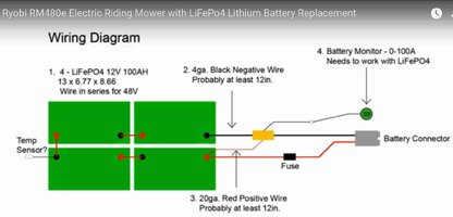

Well... You had me marked correctly... as I just made the 'Leap Of Electrical Faith' by Pulling The Pin necessary to remedy the lamentable and sad shape my front yard has become since I injured my left hand (The Viking's Disease) so many months ago. So... I cannot wait for this solution to get here ...ASAP.
My main concern was having to twice wrangle with the nearly 70 Lbs per battery (Times 8) that comes with having to replace those Four Dead 100 Amp Hour Boat Anchors resting on that slide rack underneath there right now. The New Li-Po Batteries weigh about 1/3 as much: about that of Two Big Boxes of Kitty Litter and so, working the Four of them into the Ryobi Tray will be fairly easy. Also, losing that amount of excess Lead Weight also means that the Electric Rear Wheels Drive Motor ...AND... The Two New Blade Motors will have a MUCH easier time of it as well.
These New Li-Fe-PO4 Batteries hold the promise of solving my present problems ...for at least a Decade to come... and for me, that would reflect my optimism of challenging what is left of my own life... By God's Fair Grace ...for my own durability when matched against the promise those New Batteries hold for being trouble free for at least that length of time.

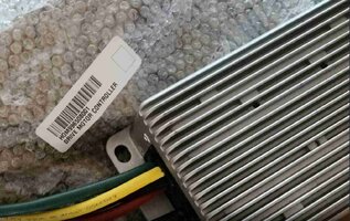

Ryobi Drive Controller Part# H0M996508001
Available HERE...
https://www.partselect.com/PS16477177-Ryobi-996508001-Drive-Motor-Controller-V.htm
...and Available HERE…
https://www.partswarehouse.com/Homelite-Ridgid-Ryobi-Drive-Motor-Controller-HM-9-p/hm-996508001.htm
It only remains to confirm with @Blckshdw that these two items match the one he purchased direct from Ryobi of Japan (@ a Comparable Price?) ...and whether or not the Strange Acceleration Issue occurred BEFORE or AFTER he replaced One of his Four AGM 75 Amp Hour Batteries... before I *Pull The Pin* and make this order from the place that can perform the Sale with the FASTEST S&H Possible:
Thanks In Advance!
PS Was it necessary to remove the Battery Tray first in order to access and R&R the Drive Controller from the driver's rear inside Chassis area?

@mrrsm I had 2 issues. The battery problem was one of my own creation, when I bought a 15 gallon ATV mounted tank sprayer to use with the mower. The pump for it was 12V, so I clamped the leads onto a single battery in the tray. Since that one battery would charge at the same rate as the other 3, it never regained it's full capacity, and eventually went dead. As a result my overall runtime slowly tanked, to the point I could only cut half of my 1/3 acre property on a "full" charge, whereas before, I could cut the entire property 3 times on a single charge.
The intermittent stop/start issue had started before that, but increased in frequency over the last couple of summers. I put the front up on ramps, then jacked up the rear to sit on jack stands so I could troubleshoot. Took me a while to get a pin out of the harnesses, but once I did, I could sit stationary in the garage, with a fan keeping me cool, and run various tests on the motor controller input connections (accelerator pedal, brake pedal, F/R selector, power and ground) with my meter to see if there was some component that was failing, causing the motor controller to stop. Long story short, every input tested remained as expected when the problem occurred, leading me to confirm it was the controller itself at fault.
After you remove the rear cover on the battery tray, you can remove the left side cover where the motor controller is. There's 4 nuts on the outside of the frame, the bolts come through from the inside. All of the connectors are shrink wrapped with some really tough stuff. Be careful when cutting through them. The white connector for the hall effect sensor is the most difficult to open up. Do that one last, as it requires the most patience. :twocents:
I ordered my replacement through the Ryobi site I gave you, and their domestic partner Gardner Inc filled the order, $377 with shipping, out of Columbus, OH, took 3 days via UPS ground. :thumbsup:

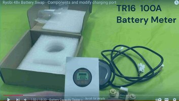

Part 1 of Two Parts showing the Hardware Set Up and Calibration Steps Photos:
AILIMONITORGAUGEDESCRIPTION.jpgENLARGEGAUGEOPENING1.jpgENLARGEGAUGEOPENING2.jpgINSERTGAUGEHARNESS1.jpgINSERTALIGNBATTERYGAUGE.jpgBATTERYSHUNTPARTS.jpgALIGNBATTERYSHUNTPARTS1.jpgALIGNBATTERYSHUNTPARTS2.jpgALIGNBATTERYSHUNTPARTS3.jpgALIGNBATTERYSHUNTPARTS4.jpgINSTALLEDBATTERYSHUNT.jpgBATTERYSHUNTCONNECTIONS.jpgTRIMBATTCOVERTOCLEARSHUNT.jpg

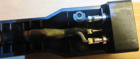

Okay… THIS one is meant just for @Blckshdw as it concerns what might come in the Mail from the Folks at HTRC for this particular 9 Stage Model # P3648 Charger for his Ryobi Model# RM480E Riding Electric Mower that might just come with a ROUND Golf Cart Connector and of course… THAT will NOT be Kosher or Convenient.
It might seem that with only Three Robust Wires to transfer in between the Two Plug-In Connectors that performing THIS Connector Swap is supposed to be *A Trivial Breeze*… But Trust me… IT AIN’T. The wiring Color Motifs and Gauges are different between Manufacturers (which really Puzzles me...) and you’ll be Playing Three Dimensional Old Harry Chess (Or Should Be...) before cutting any wires from either Plug and wind up in trouble without thinking of their arrangements carefully.
The REAL Problem though is that IF you don’t ensure that a MOD is made that will “Light Up The Green Light" on the Female Tri-Post Receptacle… it is very possible to Drive Down the Ramp from inside your Shed WITH the LiFePo4 Charger STILL Attached to the Mower!
The MODDING suggested in the Video that follows on below is VERY edifying. However, the Ryobi OEM Tri-Connector you will be Pirating from that Heavy Ribbed Aluminum Box is a Different Kind of Animal that the Wire-Fly Crimping Tool and Wire-Fly Sealing Butt Connectors made Very Quick Work of once I ensured how everything was supposed to Come Apart and then get Re-Assembled about 20 Times...just to make Damned Certain of “WUUUT Gets CUUUT?” because of all the people we know with the Chops to perform exotic Electrical and Electronic Work… You know only TOO Well that..”Wires NEVER Grow Back…”
I took the most critical images of how this all worked out..but only AFTER I Staged Assembly of the Connected Pins so that BEFORE I “Put The Music” to those Butt Connectors inside the Wire-Fly Clamp Pliers that the FLATS on the bottoms of ALL THREE PINS Pins were Flat and Even on the Counter Top and oriented without stress so that the Wire Strands would not be experiencing the slightest Radial Torque and have them work harden or pull loose over time.
RYOBICONNECTSWAP1.jpgRYOBICONNECTSWAP2.jpgRYOBICONNECTSWAP3.jpgRYOBICONNECTSWAP4.jpgRYOBICONNECTSWAP5.jpgRYOBICONNECTSWAP6.jpgRYOBICONNECTSWAP7.jpgRYOBICONNECTSWAP8.jpgRYOBICONNECTSWAP9.jpgRYOBICONNECTSWAP10.jpg

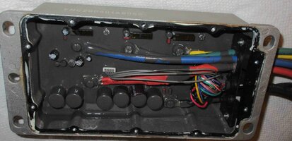

Following up on suggestions made by @Blckshdw in Post #864, I managed to get through the First Half of this LiFePO4 Battery R&R this morning and took particular care to memorialize ALL of the Battery Cage Harness and Sub-Harness connections as "Before and After" removal steps ONLY and then managed to remove the Four Heavy AGM Batteries onto my Gorilla Kart (Very Handy because NOW it has Solid, Flat-Free Tires). I'll continue with the R&R of the Ryobi Deck Motor Controller tomorrow morning.
Your BFF when working away on this Equipment is to have and use several cans of "Canned Air" to be able to constantly clear away dried grass clippings and plain old DIRT from every Nook & Cranny... as it makes everything so much easier to work with. The other items in support of the work are Two Cinder Blocks and a section of Wide, Thin Board to slide the Battery Cage out on the Rack ...and NOT lose control of the 280 Lbs LOAD just setting on that Tray:
IMG_8814.JPGIMG_8815.JPGIMG_8816.JPGIMG_8818.JPGIMG_8821.JPGIMG_8822.JPGIMG_8823.JPGIMG_8824.JPGIMG_8825.JPGIMG_8826.JPGIMG_8827.JPGIMG_8829.JPGIMG_8830.JPGIMG_8831.JPGIMG_8833.JPGIMG_8834.JPGIMG_8836.JPGIMG_8838.JPGIMG_8839.JPGIMG_8840.JPG
Another Day... Another Installment of this fascinating repair of the Ryobi Model# RM480E RELM undergoing substantial re-fitting of its Old AGM Batteries and its Primary Deck Motor and Drive Motor Controller:
Part 2
For anyone in need of performing these Detail Heavy Tasks...Heed the admonitions and warnings provided by @Blckshdw that I'll amplify here by itemizing a few steps:
(1) It will take at least Three Cans of Canned Air and a Handful of Soaking Wet Paper Shop Towels to clean off all of the surfaces of everything being Touched, Removed or Replaced.
(2) Use the SHARPEST Razor you can find...VERY CAREFULLY. If Brain Surgeons could get away with it, they would operate on people using Butter Knives. But... they KNOW Better Because you can CUT yourself badly or DAMAGE the things you are working around using EXCESSIVE FORCE AND PRESSURE DUE TO USING A DULL BLADE. The images below show WHY I chose using the latter in this case and applied its Slicing Power Very Judiciously.
(3) Throw in getting a Mixed Sizes Bag of Nylon Zip Ties for the re-assembly of the Electrical Connectors because in addition to the *:Listening for them to CLICK Together* events for EACH and EVERY One...they will need to be secured prior to being wrapped back up in their Original Plastic Shrink Wraps and finally ensconced with Black Electric Tap Wrappings... BUT FIRST, they must be firmly connected together and secured by means of using a Single Zip-Tie Looped around each opposing Connector Wires and then CINCHED TOGETHER in between lengthwise, using a Third Longer Zip-Tie to Solidly Bind the Two Halves and thus, prevent their Accidental Separation under Very Harsh Operating Conditions.
(4) The Better you PLAN IN ADVANCE to have everything you'll need before beginning ANY work at all...And then... Work Slowly and Carefully ...The Better you will enjoy doing something that can go SIDEWAYS very quickly if you are NOT Very Careful with Those *SHARPS*!
(5) The issue that @Blckshdw pointed out about having the *Strange - Starts & Stops* may have been the result of the Back Plate on the Deck Motor Controller RUSTING AROUND THE PERIMETER and allowing water and corrosion to set up on the interior PCB and Innards. I'll be performing an Autopsy on this device later on to delve deeper inside of it and see if this Expensive Thing can be repaired and perhaps put back on the shelf as a Spare.I'm going to clean the Back Plate of the Controller with Alcohol and apply a layer of GRAY HI-TEMP RTV around that Cover Seam as "Preventive Medicine" on the New One.

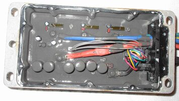

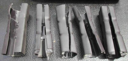

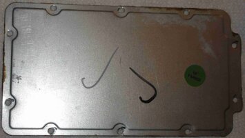

Okay... Things were moving along yesterday and were very good once I assembled the New Drive Motor Controller in the Lower Left Rear Side Chassis of the Ryobi Model# RM480E RELM. It followed on that I Zip-Tied and Double Tesa-Taped each of the Color-Coded Cables and then set about orienting the Four New LiFePO4 Batteries onto the Rack along with fastening each of the Battery Harness Color-Coded Segments onto the Battery Posts.
Essentially, the only things that remained then to do were to use the T-30 Socket on my Extra Long 120 *Click* 1/4" Drive Ratchet (What a SWEET Device THAT Tool Truly IS!) and remove the Console Cover. Then while tilting the Free Panel at a Right Angle, I carefully moved the Two Blue & Red Wire Terminals on the Key Switch from the Two Pins situated onthe Right Side Bottom ...One Pin Over... (Just One Ping, Vasily!) at a Time and then plugged them back into what is the ACC (Left Side) of that Chrome Steel Switch and then... I re-fastened the Console Panel afterwards with the T-30 Fasteners.
With that work done and with my usual Mechanic's Superstition of "NOT PUTTING THE FASCIA PIECES BACK ON THE MACHINE BEFORE YOU KNOW THAT IT WORKS...". I hopped up into the Driver's (Rider's?) Seat and Very Gingerly... Inserted the Ryobi Key into the Activation Switch. And... Just as I suspected... as I tested the Old "KEY-ON" Position by making a Half-Turn (Clockwise) to the Right... Nothing Happened. Then, I simply turned that Key 180 Degrees (Counter-Clockwise) to the Left... and OMG... IT WORKED!
It was right then that I realized that my Freshly Charged LiFePO4 Batteries were sending power through the Accessory Harness to the (NOW USELESS) Console Power Gauge . So it only remained for me to make a VERY Tenuous Test of the Drive System. So I Mashed the Forward-Neutral-Reverse Push Down, toggling it down to the FORWARD Position and VERY Lightly depressed the ACC Pedal with my Right Foot...and so... We were SLOWLY MOVING AHEAD.
Even with being THRILLED at this Victory Repair thus far...I was still afraid to move away too far from the present work location in my Back Yard, so I came to a HALT and then depressed the Toggle Switch to the Reverse Position and repeated the gingerly action of lightly depressing the ACC Pedal a second time. Once again, an indelible grin spread across my Ancient Kisser as we moved slowly BACKWARDS and I could hear what was then MUSIC TO MY EARS under the circumstances of that LOUD WARNING SIREN...Blaring briefly until I came to a HALT.
Wow... THIS meant that EVERYTHING I had seen up to that point of all the Instructive Videos for making this dramatic swap from AGM Batteries over to the Miraculous LiFePO4 Batteries ...WAS ABSOLUTELY TRUE. But...as tired as I was from Heat Fatigue and working outside on this project all that day... I SHOULD have just STOPPED RIGHT THEN. But the Old Adage, "Act In Haste...Suffer at Leisure" Bug crawled out of that Ryobi Machine ...and BIT ME!
I was so anxious to "Test" my newly assembled, modified Tri-Plug Harness for the New HTRC LiFePO4 48 Volt Charger...that I simply hooked up the 120 VAC Power Cord to the side of the Power Brick and as soon as I plugged in the Tri-Connector... the Green Power-On Light at the Rear End of the Charging Station Feature and immediately, I could smell something BURNING under the Upper Plastic Upper Cover. Uh Oh... HERE We GO... I thought.
Of course... I instantly YANKED that Friggin' Modded Tri-Plug RTF outta there and THAT calmed things down from the prior sound of ...something sizzling under there. So then I stopped and studied the situation for a moment, wondering if I had made some sort of Sad Mistake by NOT wiring up the Four Batteries in Series correctly. But recall that I had already engaged the Electric Drive Motor...Twice... and so I decided it could NOT be THAT. Still... I had to THINK about what had just occurred and I decided to Bag and Box up everything in the Back Yard and after Parking the Gear in my Arrow Shed... and finally, it was time to "Call IT a Day..."
The next morning, I made a mental review of the "Modification" I had made when Swapping that GD Golf Cart Connector over to the Clipped- Off OEM Tri-Connector and reasoned out that ADDING IN THAT THIRD PIN WIRE WAS A VERY BAD IDEA. I'm sticking with the Idea that THIS was probably where the FUBAR had started and that got me to thinking whether or not anything ELSE had gotten COOKED under there. So I "Hit The Books" by hitting up YouTube searching for other FUBAR Vidz to absorb and keep working though these issues.

Having seen this Project head momentarily... sideways, I reviewed THESE Videos linked below to glean some more information about the Working (and Non-Working) Features wrapped up in that Power Triangular Shaped Connector.
But then I sort of -* FREAKED OUT*- for a while over the possibility of using a completely different design of a Re-Charging Harness instead and perhaps sidestep using the Triangle Shaped Connector (or anything like it) altogether. This had only occurred to me AFTER reviewing the contents of the HTRC 48 Volt DC LIFePO4 Shipping Box and its Contents.
What I saw in there prompted me to use the HTRC "Red & Black Jumper Cables Adapter Harness" and I wound up just...Clipping OFF those Red & Black Battery Terminal Clamps from it. Previously, I had ventured out back in the Yard to remove and loosen the Upper Black Plastic Covering under the Seat when folded forwards and investigate what it was that might have been "Cooked" under there on the previous day.
Once I spied those "Red & Black" Small Gauge Charging Wires that lead back to the Triangular Female Charging Port...I decided to JUST GET RID OF IT ...and come up with a Better Idea that would provide an Alternative Light Harness to mate up with the HTRC Charging Brick, :>)
These images memorialize my use of my Hot Air-Soldering Work Station on top of a piece of Fireproof Concrete Board that I like to use from time to time on such projects. The purpose here was to *Clip* Off and save the Two Quite Excellent Battery Clamps with enough length of wires left on them to be used in another manner on another Project.
Then the idea was to mate the Red and Black Wires up with the Blue Connector Power Charging Wire Harness underneath the Back Upper Section of the Ryobi Heavy Duty Connector.. .and thus, create a Well Made and Durable Harness that I can LEAVE attached Under the Seat...and whenever needed... Just Plug the Yellow Connector into the side of the HTRC 48 Volt DC Power Brick whenever it is necessary to Charge ALL of the LiFePO4 Battery Set of the Ryobi RELM:

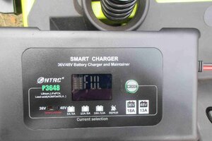

What happened AFTER Creating and Installing this Adapted Harness was REMARKABLE! I mentioned in Prior Postings about the ABSOLUTE NECESSITY of Charging EACH LiFePO4 Battery INDIVIDUALLY and to its FULLEST EXTENT as indicated on the HTRC SMART LiFePO4 12 Volts DC 20 AH Charger Screen. And so I followed my own instructions to the LETTER. What this meant was that within just a few minutes after installing the other HTRC 48 Volts DC 18AH -13AH LiFePO4 Battery Charger with the New Cable illustrated below...IT ONLY TOOK A FEW MINUTES TO BRING ALL FOUR BATTERIES UP TO THEIR "FULL" LEVELS AS INDICATED ON THE CHARGER LED SCREEN!
This was REAL PROGRESS Today after having the issue with the FUBAR'd Triangular Charging Connector. Henceforth, all I need to do whenever the Four LiFEPO4 Batteries require future charging is to Raise the Seat and Un-Clip the Tie Wraps holding the New Harness in place under the Seat... Then Plug It Into the Side of the HTRC 48 Volts DC 8-13AH on those Settings and allow them to continue to Charge Until FULL.
Tomorrow is Another Day and I'll tackle the latest issue as to WHY with having Four FULLY Charged LiFEPO4 Batteries down there... that when I Turn the Key to the LEFT (or to the Right)... Nothing Happens. I'm really not too concerned about this right now, because if the Batteries or the Motors had been DAMAGED yesterday... then the New HTRC 48 Volts DC Charger would NOT have worked today as well as it did.

I found this Most Excellent Dual Component-Electrical Harnessing Layout EVER with some close-ups for the areas that concern the Charging and Safety Circuits for this Ryobi Model# RM480E RELM just now... so it is worth dropping them all in on this Thread for the *Now* and Future Needs of anyone to refer to them:

What apparently happened involved those Shitty Little Dinky Color Coded Controller Wiring Harness Connectors that can either break or Flex from Vibration and momentarily Lose Electrical Contact or Fail for wiring harness damage reasons ...and of course, were fairly easy to repair with Common Wire Connectors of a more Robust design.
When I was replacing my Old Drive Motor Controller just a few days ago... I noticed that even with their connectors being LARGER...I thought it very wise to Zip-Tie them ALL and then use Black Impregnated Fabric Tesa-Tape to Double Bind them for Weather and Wear Protection.
I also wanted to prevent the accidental occurrence of any Electrically ARC-ing happening from any "casual" contact happening in between the Two Sides of the Harness Matrices on the Two Small Controllers mounted on the Right Frame of the Mower from the Ordinary Actions and Vibrations induced by the natural operational environments that ALL Lawn Mowers MUST be able to Endure.
So for my OWN Peace of mind and that of @Blckshdw & any Other Members owning these Ryobi RELMS... Please... Watch THESE Videos:

(1) Anderson Connectors SB-50 Quick-Connect (Heavy Duty Gray Male to Female on 6-8 AGW Wiring) On Order...
(2) XT60 Connectors (Orange Colored Mates to side of HTRC Chargers) Male & Female on 12 AGW Wiring) Arrived...
I have ordered multiple sets of these Male-Female Connectors in order to create and prepare Secondary Charging Harnesses (including re-purposing the Heavy Copper Positive & Negative Battery Post Clamps I removed to create an Alternative Charging Harness).
Having these on hand will allow me to use either one ... or ...both of the Two different HTRC Charging Units and choose between either Charging Each INDIVIDUAL LiFePO4 Battery at 12 Volts DC @ 20AH Rate of Charge … or… Charging ALL FOUR LiFePO4 Batteries as a Group, using the HTRC 48 Volts DC @ 13AH Rate of charge instead.

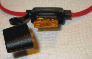

Because I am very superstitious about Unintended Consequences with New Tech that may FAIL Unexpectedly... I like to Hedge My Bets...and Obtain any Rare & Expensive Components and Parts of any such Gear as these opportunities arise.
In THIS Case...it was the Start Solenoid that uses the Low Amperage-Voltage as the Key is Turned to "Throw the High Amperage High Voltage Contacts together" ... and prevent the Shock of this from melting the Electrical Contacts in the Switch together.
I would rather HAVE One of THESE Now...and NOT Need IT...Than NEED One Later...and NOT be able to Find IT. Best Price & Availability came from eBay @ $40.00 for this Unit:

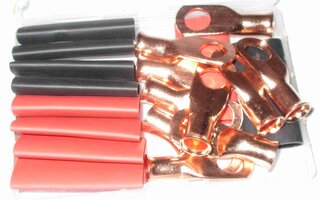

The rest of the "Anderson Electrical Connectors" just arrived via eBay and since THESE are made specifically to accommodate 8 AWG Wire.... THESE Two Aussie Videos coming from "The Land Down Under" go a VERY LONG Way...in a... Very Short Time with Excellent Explanations of How these Special and Convenient Connectors are supposed to be Assembled:
And just to be on "The Safest Side"...I'll be using THIS Gear and Tooling to ensure that the "Crimp-To-Wire Bonding" is put together in The BEST Way Possible:

(10) Pull The Seat Forward... Then Set Up the HTRC Model# 3648 Charger ...for 2-5 Hours.
(11) Unlike the AGM Charger...When the HTRC Reads "FULL"... UN-PLUG The Charger.

Okay...There is STILL a bit more to cover where these LiFePO4 Batteries are concerned. The Truth is that when these Batteries are hooked up in SERIES...even if they are Properly Topped Off One At A Time when Brand New...over time...they WILL wind up presenting with DIFFERENT Voltages that will Charge and Discharge at DIFFERENT Rates and can degrade both their Performance AND Longevity.
However...the LI Time Company that makes them also produces a Battery Balancer that can ensure they assume the proper Electrical Potential between All Four Batteries...without this having to be consciously monitored over time. Likewise...their Panel Gauge Kit is a MUCH Better Version than the Green Colored 2 1/8" Circle Gauge that can provide an EZR Screen to Read.
Also.. The Three Composite Wrench Set is a SAFER Tool to be using around Open Battery Terminals than Highly Conductive, Long Handled Chrome Vanadium Steel Ratchet might get into trouble if it accidentally Short Circuited between the Ground and B+ Terminals while wrangling all of these 4AWG Cables into place:
4AWGCOPPERFITTINGS.jpg4AWGCOPPERGROUNDCABLE.jpgBATTERIESIMBALANCEDOVERTIME.jpgBATTERYREBALANCER.jpgBATTERYTERMINALCOVERS.jpgCOMPOSITEWRENCHSET.jpgIMG_0382.JPGIMG_0383.JPGIMG_0384.JPGIMG_0399.JPGIMG_0400.JPGIMG_0403.JPGIMG_0405.JPGIMG_0408.JPGIMG_0412.JPGIMG_0413.JPGIMG_0418.JPGIMG_0419.JPGIMG_0424.JPGLITIMEBATTERYMONITOR.jpg

Revisiting Post#4 in this Thread hearkens back to the actions taken by @Blckshdw to replace the Drive Motor Controller of his Ryobi RM480E RELM as per the image he provided us within Post# 2,270 via THIS Link:
I too made an identical purchase of this Drive Motor Controller, ostensibly manufactured by "HOME-LITE" for Golf Carts and of course the Ryobi RELMs and I have kept my promise to perform an Autopsy upon mine; strictly to see just how far the Rusty Back Cover areas might have dissolved away... and perhaps be enough to have compromised "The Innards" of this Unit.
What I discovered was that after removing the #2 Philips Screws around the Perimeter was that the Sealing of this Unit is accomplished by their use of a Thin, Stiff, Molded Black Plastic Gasket conforming to the general outline of the slender inner casting flange and surrounding the cover mount holes cast into the aluminum body of the upper ribbed base.
To this they added a sketchy and poorly applied spray of what looks like a Beige or Tope Colored Latex Sealant that was not evenly distributed around the inner perimeter. Directly inside and covering all of "The Works" was a mass of "Gray Goo" that appears to be very much like the "Electrical Glyptol Paint" used to Fuse and Seal Up Electric Motor Windings and Casements and in this "case", it was very thickly (and quite hastily) applied during the post-assembly of the Electronic Board Innards moments before screwing down the Back Cover and being set aside to dry upon a shelf.
This material seems meant to achieve the three purposes of: (1) Heat Insulation, (2) Weather-Proofing and (3) Vibration Damping; probably considered during its development for handling the Bumpy, Vibration Heavy and Rough-N-Tumble Shake-Rich working environment encountered on Golf Courses and-or of course... When applied to driving Electric Powered Lawn Mowers hither an yon while Cutting Wet Grass by the Bushel Baskets Full.
I did not take the time to uncover the tops of all the Large Capacitors present to see if any of them were swollen or failing and thus, the ultimate cause of the "Sketchy Starts and Unexpected Stops" I was experiencing when depressing the ACC Pedal will remain a Mystery... Mostly because by simply replacing this entire unit, my RELM Runs Right as Rain now after performing this Drive Motor Controller R&R.
Nonetheless... I don't doubt that this nearly $400.00 Unit can probably be resurrected if it is thoroughly cleaned up and then tested for simple component failures.
20240319_170424_resize.jpgIMG_0374.JPGIMG_0376.JPGIMG_0377.JPGIMG_0378.JPGIMG_0380.JPGIMG_0381.JPG
