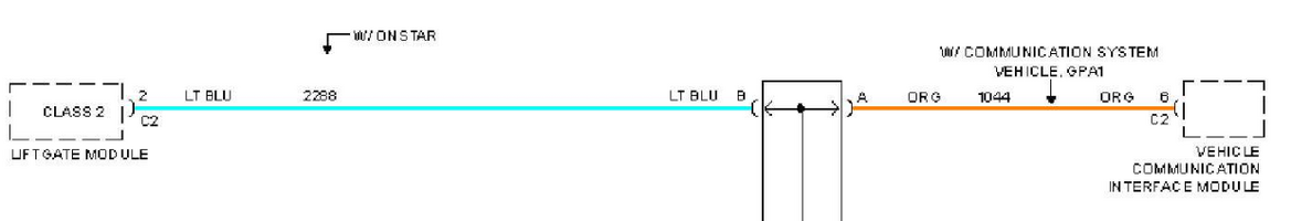

I found an ORANGE wire cut on SP206.
Located under passenger side rear seat.

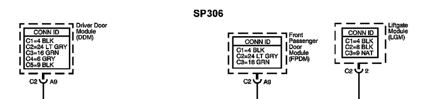

Found a partial pinout for CDF, but nothing for AB. (below)
Note that I have no Light Green wire in this splice block
SP206
Dark Blue/White F (No E wire)
Tan D
Brown C
Light Blue B
Orange (cut) A
I'm guessing that the orange wire was part of the data stream from the OnStar module because it has been disabled by previous owner.

Orange (cut) A
SP206
Found in my manuals. The manuals on Charm were useless for this specific item.
The link to my manuals is in my signature.
I've downloaded EVERTHING you made available, but even when you sent this, it took me a while to find the word SP206. Cataract surgery this summer.
So, the orange wire goes to the OnStar (vehicle communication interface).
All the wires going into that splice block are connected to a single point.
