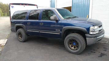

Ok guys (and gals), long time listener, first time poster. This is going to be a LONGGG post, so sit down, strap in, and get ready for some babbling.
Lets see where to start. I own Olson Kustom Works, we mainly do LSA swap parts for almost every LS platform on the planet. I have an extensive electronics and mechanical background, as well as the machining/manufacturing side of things (I mean, we make parts, so I hope I know what Im doing). I have 3 LSA powered GMT800s, and a 2650 powered GMT900 tahoe, but the GMT800 Suburban that i have been building for a few years is the one that has some fanciness that I need the GMTNation help with.
Heres a short list of mods done to this 2000 1500 4x4 chassis so far (not including most of the interior stuff), just so you know what Im working with here. This thing started life as a 5.3/4L60 4x4 model, and It got a little out of hand. I was going to swap all this 8 lug stuff into my 2000 Yukon, but I liked the condition of the Burb better.

Pic For Attention

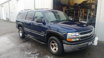

Where we started:

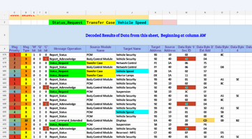

I am on Mountain Time so just rising here. Tossed your logfile into this spreadsheet here and have just started to have a look. I will be the first to say my spreadsheets are at best a hack. I am no programmer, I just toss together stuff to suit my purposes. So there may be some stuff requiring adjustments on my end. Usually the first thing I do is scan for any node addresses that I don't already have identified in the spreadsheet. So far I see only the usual suspects.

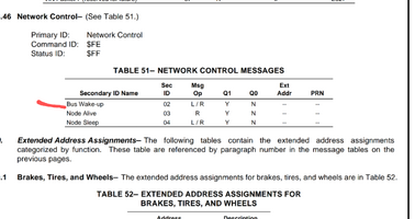

I find this odd. In it's native installation the TCCM in the Envoy is powered hot all the time and awakens with any network activity such as opening a door or pressing a keyfob button. Is this how it is currently installed?
It looks like the logfile begins after the network is already awake as I see no wakeup sequence. Is this correct?
Something unrelated I notice. There is an avalanche of "Vehicle Security" message traffic between your PCM and BCM. Approaching 70% of the total traffic. These are high priority messages that will win the message arbitration and use the bus before the bulk of other data traffic as well. Seems highly suspect. Know of any reason for this?
The TCCM is powered hot all the time with the main power, but doesnt "wake up" until the engine is running. the 246 TCCM in the other GMT800s I have will power up with key on, I think its something just in the OS for the 263 Tcase, or at least thats what the service manual says
Normally, as far as I know, any module can send what is specified in SAE J2178 as a "bus wake up" message. You open a door and that door module does it. Press a keyfob unlock button and the receiving module does it. Unless the OS flashed to that TCCM somehow disables that I would expect it to wake up upon transmission of the wake up message like it did in it's source vehicle.
hmm, reading through the documentation again for the GM service manual, it does say the key needs to be in the RUN position, but doesnt specify that the engine needs to be running. I think I saw that elsewhere, but I dont remember where it was.

Sooo.. before the TCCM wakes up the PCM and EBCM repeatedly ask for the 4WD system status. Naturally there are no answers since the TCCM is inactive. When the TCCM does come online it announces it is awake, reports the 4WD system status. The PCM acknowledges this and the TCCM then instructs the PCM to load several bytes of unknown data from the TCCM. Next the EBCM acknowledges the 4WD system status.
The next thing I see is interesting in that the TCCM acknowledges a message sent by the PCM about 0.12 seconds before the TCCM announced it was awake! The PCM message was an announcement of "actual gear position with shift in progress".
The TCCM goes on to request all manner of data. The network status, throttle position, vehicle speed, something about interior lamps??, as well as the running status of the engine which at the time of the request was running.
this was Dmax Swaps email to me earlier this week
So I can identify the TCCM requesting the actual gear position, the PCM reporting that status, and the TCCM acknowledging that status report.
The example I see first begins at timestamp 00:17:17.961 with the TCCM making the request. The PCM answers at the very same timestamp and the TCCM acknowledges at 00:17:18.041
So that doesn't seem to be the issue here.

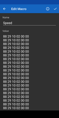

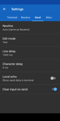

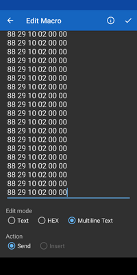

I gave that macro a try, and it sent out ok every 1 second, but 4LO still didnt work, no matter the shift position. I will have to log a vehicle that the TCCM should have been in and maybe there is a different code that is used in a different ECM?
Well I have an 02 TrailBlazer and that should be the same as the Envoy you got that TCCM from. I have been studying my data looking for clues and differences between your log file and my vehicles. I also own an 05 Yukon so I have looked over that system bus traffic as well.
So you said the programmers reflashed that TCCM with a different OS?? You may have said what that TCCM was flashed with, I can't remember.
Oh CRAP!!
I just now remembered that in that macro I totally forgot to separate the header from the message body!! It can't work like I typed it!!
I will edit this message in a moment with the correct macro!!
Copy/paste this into the macro editor.
