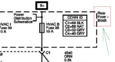

For reference this is the schematic I'm using:
Re: @budwich 's observations in Post #7... Since the EBCM is responsive to Power Draws to Ground (G304) during ABS Events... It won't hurt to Check the Ground there for any signs of having either a Broken Wire-Loose Wire-Corrosion where the EBCM Unit is Bolted to the Driver's Side Under Frame adjacent the Driver;s Door:
Thanks, I will check that one.
Which pin exactly?
I screwed up and didn't look at all of the schematic close enough... the "in feeding power" and the outputs to the resistor block are in the same 7 pin connector... :-( thus leaving that connector in place makes it difficult to access the "in feed" power pin (G on the schematic).
Thus you need to be a bit more "sneaky". You have to go to the fuse box, pull fuse 44 on the rear box and do your measurement at that point for the outgoing portion. Hopefully, you can find a ground point close by for the black lead. Hope that makes sense.
NOTE: ensure that you are on the outgoing portion of the fuse socket or you may blow your meter if you are on the voltage side. Of course, you can check that with a quick voltage measurement... checking with both key off and key in run on both the fuse socket points.
Worked on this this morning and pulled some numbers. Found a good ground at the rear fuse box and pulled fuse 44. Put a probe in the outgoing fuse pin and with the resistor pack and motor connector plugged in this is what I got:
