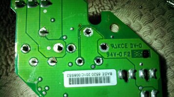

I have done a repair before and have pics. Mine was doing the same thing and it was one of the spdt micro relays on the wiper motor. I replaced both of them and it has been working great. Unless you are very handy with a soldering iron it is better to just buy a used one on eBay.
Here are pics of the board and the 2 relays. If you want to try it I have more of the relays available.
