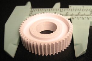

This is the 49-tooth version that I quickly printed last night, from an enhanced version of that OpenSCAD script I posted earlier:
Even with no tweaks to the layer height or lowering of print speed (or any other techniques meant to improve quality/resolution), it came out better than I expected! I will definitely be pursuing this option if any of these actuator gears fail in the future.
It's a little hard to tell from the photo but it appears to be what I would describe as 'moderate' resolution; if you used default settings and have room for improvement you may have something really workable for the application. How accurate were the dimensions? One of my concerns would be the I.D. as it needs to be a press fit on the metal hub (unless you use a technique similar to my roll pin to lock it down). I noticed on the metal hubs that they had two small flats which you could incorporate into your design, that way you wouldn't have to be so finicky about the final dimension, in fact you could even make it a slip fit so that there wouldn't be any imposed stress on the gear that might lead to the original problem again.

Sorry for the low-res photo. I shrunk it to keep the uploaded file size manageable.
It's certainly not a perfect gear, but there are many things I could do to try to improve it, including some I didn't even mention yet, like enabling "random seams". And, for the record, I did no cleanup whatsoever on the teeth -- it came off the printer just as you see it.
Now, to be clear, this was printed with PLA filament. I would not use that in a real gear that was subject to the interior temperatures in a vehicle (especially in Arizona!). So were I to do this "for real", I'd want to print it in something that could better stand up to the heat (maybe PETG or ABS -- I'm not really sure there). And I'd need to re-calibrate and tweak the print settings a bit for the new filament type. So, for now, this is all an exercise in "possibilities".
I think it was quite good, but my standards might be (far?) lower than someone with a background in machining (etc). I substituted my digital, metal calipers for the plastic ones in the photo and took some measurements. The shaft hole, which should be 14.0 mm is 13.8 mm (1.4% off). For a part like this, that seems "good enough" to me, but of course, even if it's not, the beauty of 3D modeling & printing this way is the ease of tweaking the model and re-printing. But again, it's getting a bit ahead of the game unless I'm printing with the appropriate filament type.
Also, I didn't put any effort into getting the actual overall gear diameter precise because there's no point until I have an actual gear to replicate. I didn't even bother trying to get the diameter exact as compared to the 3D model I linked to. I just set that "circ_pitch" value in the "spur_gear" routine to make it come out reasonably close to the linked model.
Generally speaking, if something is not printing with adequate dimensional accuracy, it's a hint that the printer should be re-calibrated. I've never bothered to do any dimensional calibration, but I know how to do so if it's needed.
Oh, yes, I think I see the flats in your photos! It looks like the original gear didn't accommodate them because I see what looks like a gap there, in your "vise" shot.
So, in other words, eliminate the "interference fit" (or, I guess some would say, "press fit") currently used by that splined shaft and utilize a gear with a slightly larger inner diameter, but with cutouts to accommodate the flats on the metal drive hub? Yes, I could easily (well, given a bit of time, given my inexperience!) add a couple of flat spots inside the gear shaft hole.
But, assuming I've understood you correctly, I wonder if the additional flexibility of movement might aggravate the gear mating? Of course, if I were to design something "for real", I'd experiment a bit to get the sizing "just right", on all dimensions.
