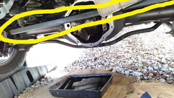

The torque arm is likely the place to start, and its bushings. Then the left and right upper and lower control arms, mounts, and bushings.

Even thou you have a floating axle, you still have a upper and lower control arm..
THis is the torque arm, goes from the far left in the pic on the axle, to a mount on the body/frame on the truck on the other side.

OK I had to climb under the truck to take a look and refresh my memory, it's been years since I've had to work on anything underneath. So yeah, that horizontal bar feels solid when I pull on each end, no obvious play around the bushings. The same for the (I presume torque arms?) that go from the bottom of the axle towards the front of the vehicle -- they both feel solid as well. The only thing I did notice was my shocks are squishy, but damn I'm not sure if I've ever replaced the rears! Might be time to do that this Summer.
Oh no, you already mentioned the torque arm is the one going across the axle..

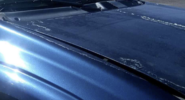

I found a blue trailblazer at the LKQ Denver location, but the fenders, and hood, both had significant clear coat peel on sun facing surfaces.
I found a Second one at the same yard that has a good hood, and drivers side fender, but had a non-painted passenger side fender. But the Blue looked possibly like a deeper blue? I didnt see a paint code. 2008 Trailblazer VIN 1GNDT13S682182113 maybe someone could see if it matches your vin?

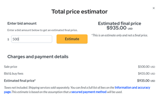

I am a member of CoPart, so I have a tab I can click to estimate the auction fees.

Wow, so basically an 87% auction fee? That's massive! Seems like I would be better off just keeping an eye on craigslist.

No, its not 87%, its a stepped system, and type of payment.
