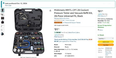

Here's something you might want to consider is to get a vacuum coolant refill kit.
  • Love
Here is that same Snap-On Kit "In Action" on a Trailblazer 4.2L LL8:
One of many (either Simple or Complete Solutions Kits... like this one) available over on Amazon:
