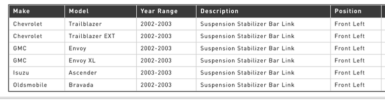

I just searched Moog for 205 Buick Rainier (continued Bravada) and came up with a different part number:
Reactions: movietvet

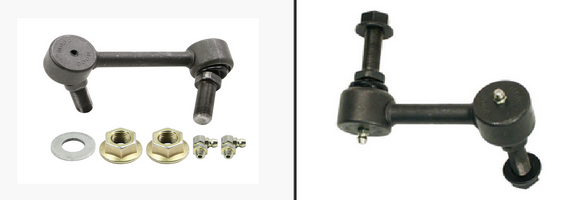

I think this is the key to my mystery. On the left is the link at Moog for the Buick Rainier and the one on the right is what is being sold as compatible with all 360 models. My eyes may be deceiving me, but the Buick part looks like it has larger diameter bolts. Also, Moog only lists the LEFT side as being available. Maybe they don't any longer make or stock any of the right hand ones.
Don't look beyond 2005 because the sway bar was changed on 2006+, being captured inside the frame rails with different end links.
The one on the left looks like it has a longer shaft. That could come into play if the Bravada/Rainier has a lower ride height.
Never mind what I said there. Despite the different sway bar, they used the same links from 02-09
Very true, and they ones on my truck are different length than either of the replacements. Well, now I know what parts I need. Thanks to all for helping me sort this out.
